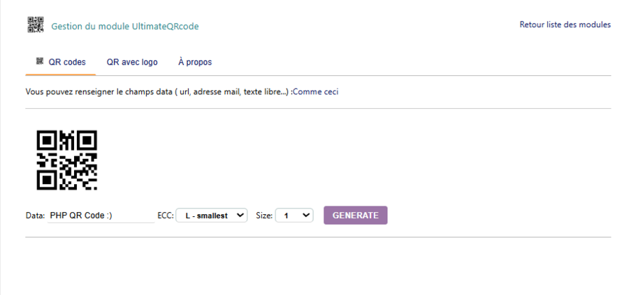

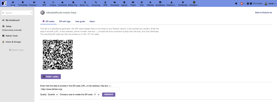

"QR codes" tab (free generator)
This tab is an on-demand QR code generator: the QR code created here is not linked to any Dolibarr record and can encode any content.
| Field | Description |
| Enter here the data to encode in the QR code | The content to encode: URL, e-mail address, phone number, free text… |
| Quality | Error correction level: • Low (L, ≈ 7 %): most compact QR code • Medium (M, ≈ 15 %): common use • Quartile (Q, ≈ 25 %): good resistance • High (H, ≈ 30 %): very resistant to dirt and scratches |
| Size | From 1 to 10 pixels per QR code module |
| GENERATE button | Generates and displays the QR code |
| PRINT LABEL button | Opens the QR code on a 120 × 57 mm label (see Label printing) |

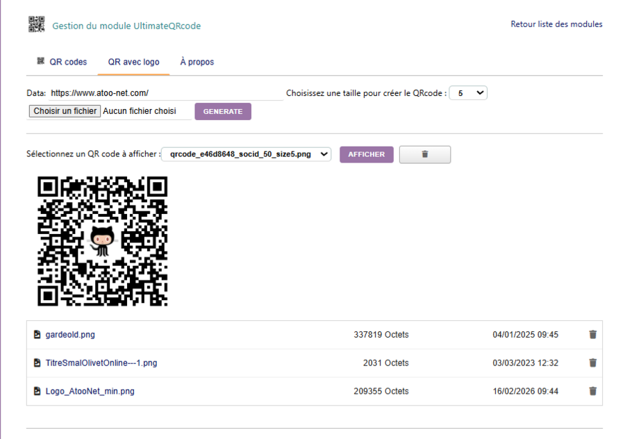

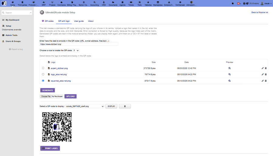

"QR with logo" tab
This tab creates a free QR code carrying a logo in its centre. Generated QR codes are kept in the module's temporary folder and can be displayed again, printed or deleted.
| Item | Description |
| Enter here the data to encode in the QR code | URL or content to encode |
| Size | From 2 to 10, controls the image resolution |
| Logo table | Logos available in documents/mycompany/logos/, with size, date, preview (magnifier), rename and delete. The radio button selects the logo to embed
| GENERATE button | Creates the QR code with the selected logo |
| UPLOAD | Adds a new logo (PNG recommended) |
| Select a QR code to display + DISPLAY | Displays a QR code generated earlier |
| Bin icon | Deletes the selected QR code, after confirmation |
| PRINT LABEL button | Prints the displayed QR code on a 120 × 57 mm label |
- Note: error correction is forced to High, because the logo hides part of the matrix.

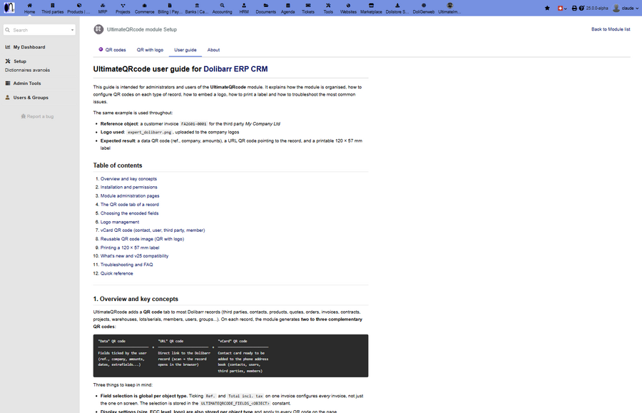

"User guide" tab
The full user guide can be read directly in Dolibarr, in the user's language (French, English, German, Spanish or Italian).

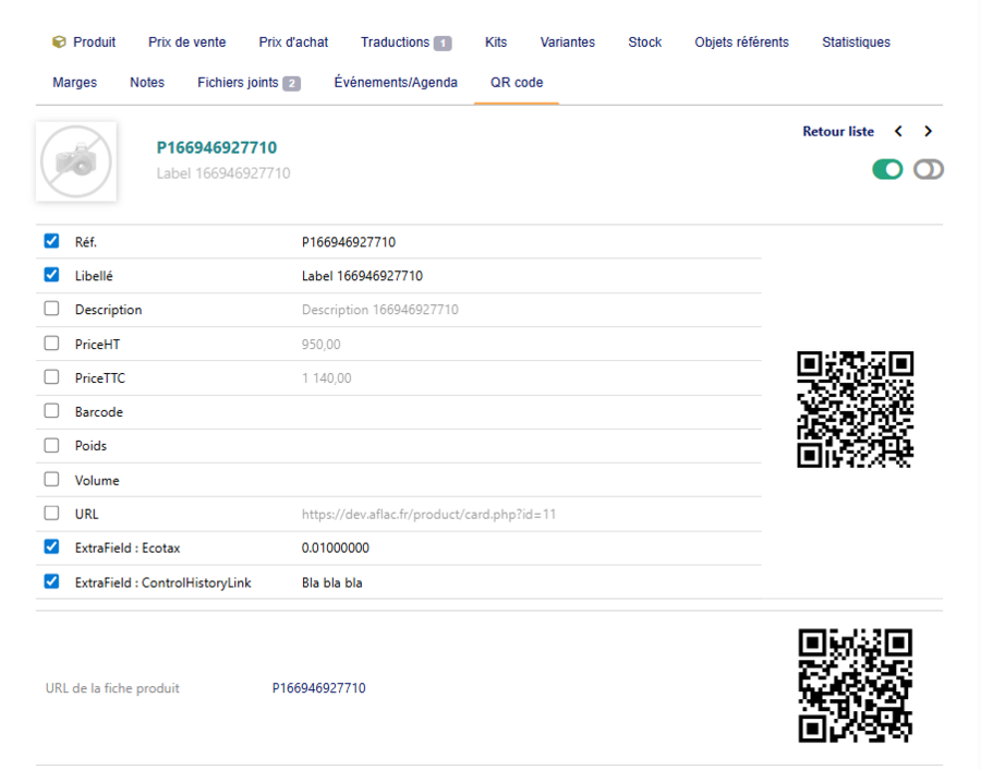

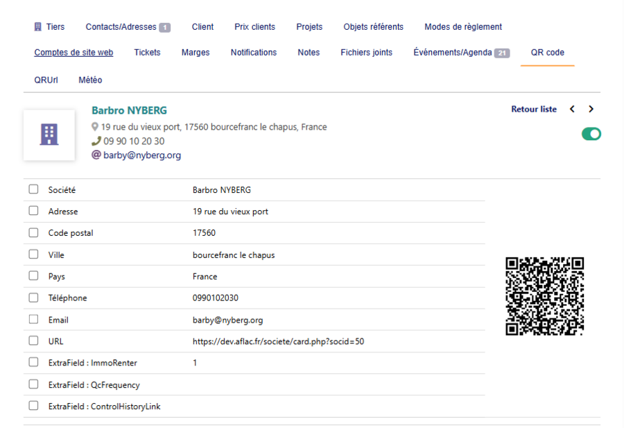

Area 3 — Data QR code
You choose the fields to encode by ticking them:
- the checkbox includes or excludes the field;
- the middle column shows the label and the current value of the field (greyed out when unticked);
- the generated QR code is displayed next to the table, with or without logo, together with the PRINT LABEL button.
Fields available per object:
| Object | Available fields |
| Third party | Company, Address, Zip code, Town, Country, Phone, Email, URL |
| Contact | First name, Last name, Phone, Mobile phone, Email, Address, Zip code, Town, Country, URL |
| User | Login, First name, Last name, Phone, Mobile phone, Email, Address, Zip code, Town, Country, URL |
| Member | First name, Last name, Phone, Personal phone, Email, Address, Zip code, Town, Country, URL |
| User group | Group name, Description, URL |
| Product / Service | Ref., Label, Description, Price excl. tax, Price incl. tax, Barcode, Weight, Volume, URL |
| Lot / Serial number | Lot/Serial, Eat-by date, Sell-by date, URL |
| Warehouse | Label, Short location name, Description, Address, Zip code, Town, Country, URL |
| Commercial proposal | Ref., Customer ref., Company, Email, Phone, Date, End of validity date, Total excl. tax, Total incl. tax, Public note, URL |
| Sales order | Ref., Customer ref., Company, Email, Phone, Date, Total excl. tax, Total incl. tax, Public note, URL |
| Purchase order | Ref., Supplier ref., Company, Email, Phone, Date, Total excl. tax, Total incl. tax, Public note, URL |
| Customer invoice | Ref., Customer ref., Company, Email, Phone, Invoice date, Payment due date, Total excl. tax, Total incl. tax, Public note, URL |
| Supplier invoice | Ref., Supplier ref., Company, Email, Phone, Invoice date, Payment due date, Total excl. tax, Total incl. tax, Public note, URL |
| Contract | Ref., Customer ref., Supplier ref., Company, Email, Phone, Contract date, Public note, URL |
| Intervention | Ref., Company, Email, Phone, Date, Description, URL |
| Project | Ref., Project label, Company, Email, Phone, Start date, End date, Public note, URL |
- Note: the extra fields filled in on the record are added to the list automatically, as Extra field: label. Those created by other modules are ignored.

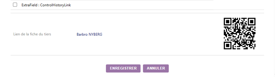

Area 4 — Record URL QR code
On the right (or below the table, depending on the screen width), the tab shows:
- the Record URL label followed by a link to the record;
- a second QR code encoding the direct URL of the record, also printable on a label;
- at the bottom of the page, the SAVE and CANCEL buttons.

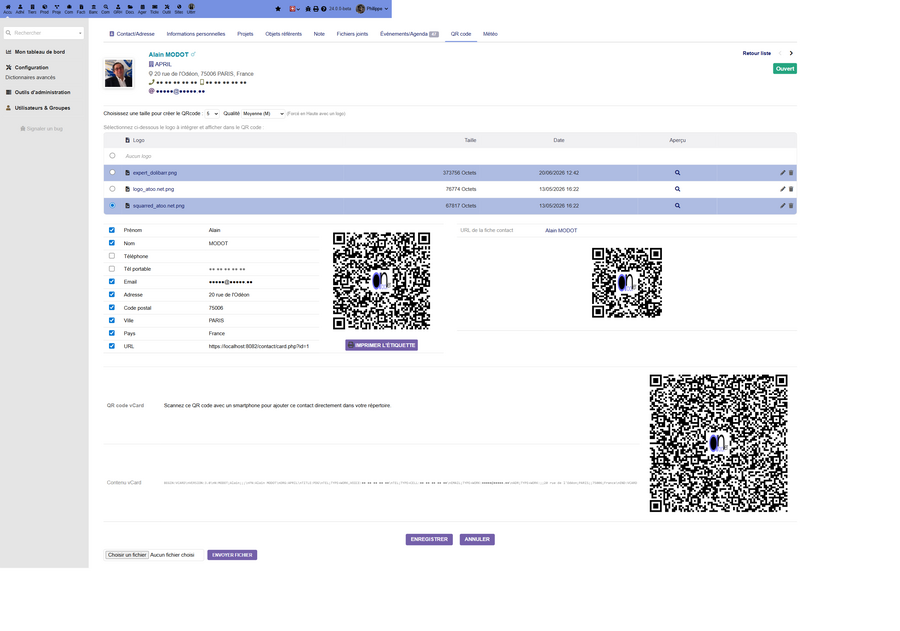

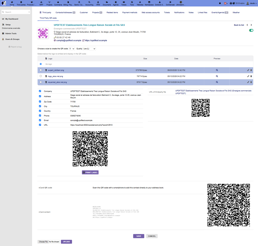

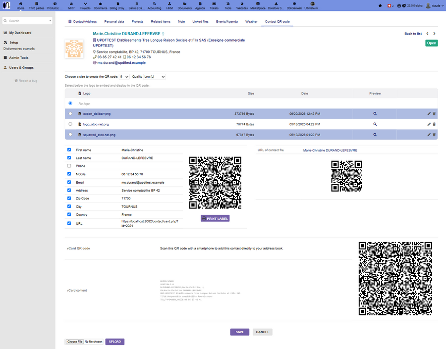

Area 5 — vCard QR code (Third party, Contact, User, Member)
The Third party, Contact, User and Member records also show a vCard QR code. Scanned with a smartphone, it offers to add the contact straight to the address book. The encoded vCard 3.0 content is displayed in plain text next to the QR code.

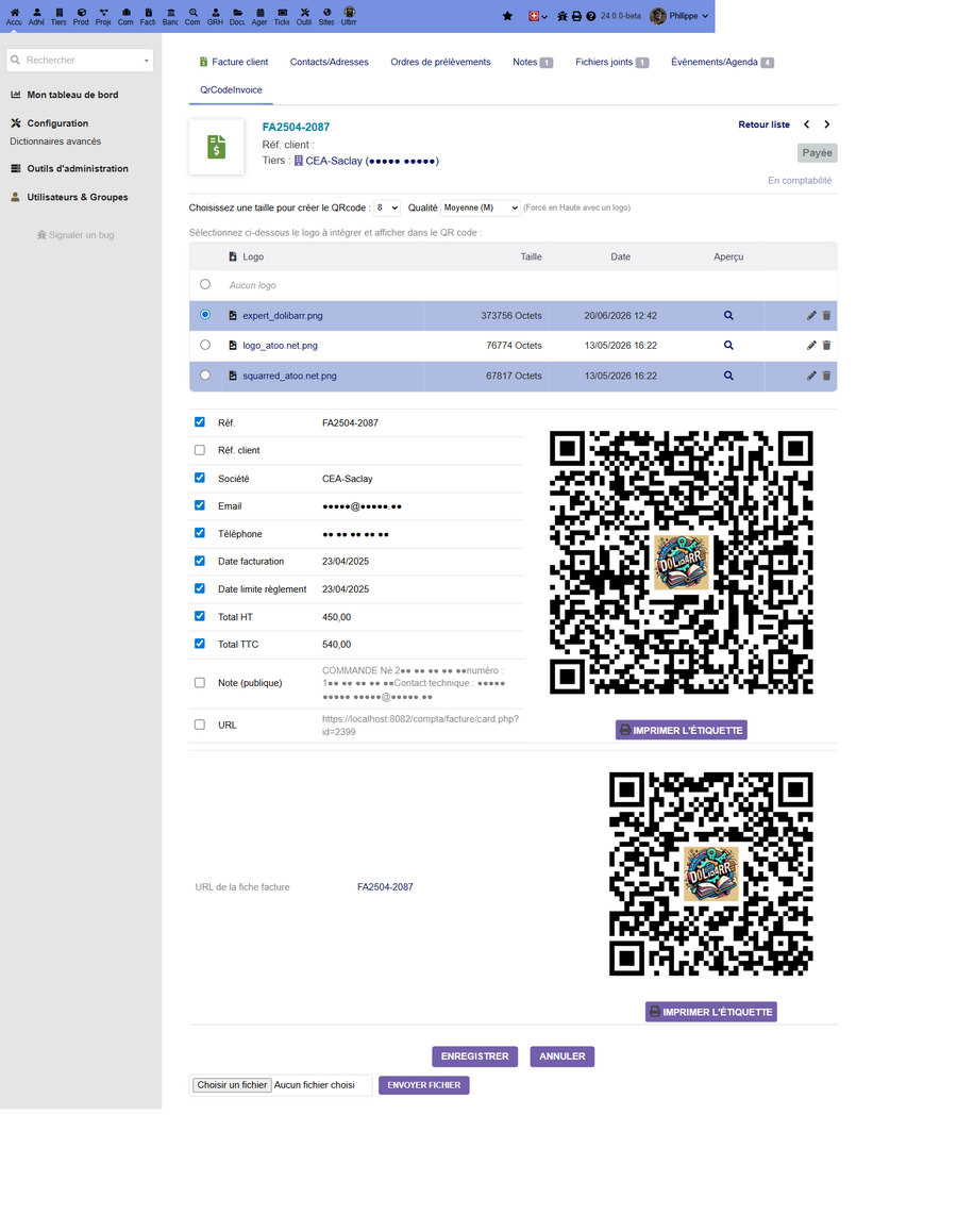

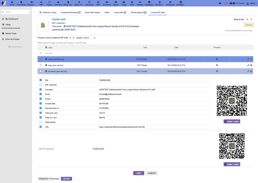

Customer invoice
Example on a customer invoice: Ref., Company, Email, Phone, Invoice date, Payment due date, Total excl. tax, Total incl. tax and URL are ticked. The expert_dolibarr.png logo is embedded in the centre of both QR codes and the quality is forced to High (H).

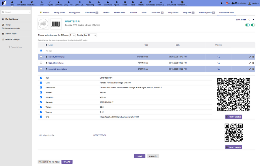

Product
On a product, the QR code can encode the reference, label, prices, barcode, weight and volume: handy for shelf or storeroom labelling.

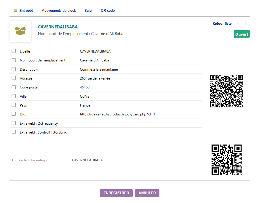

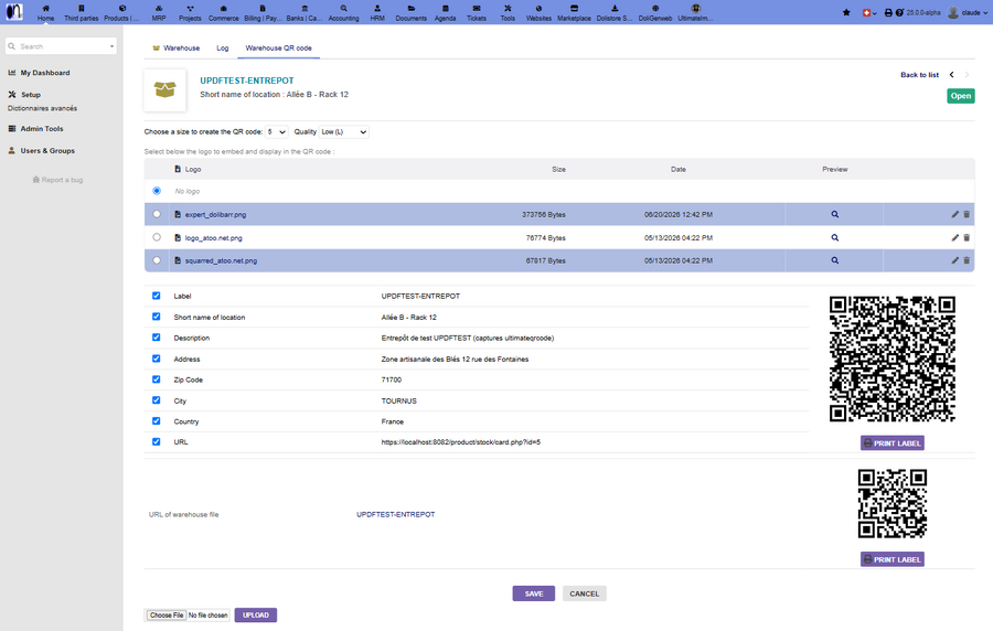

Warehouse
Useful to identify storage locations physically. The Short location name field specifies the area (aisle, rack…).

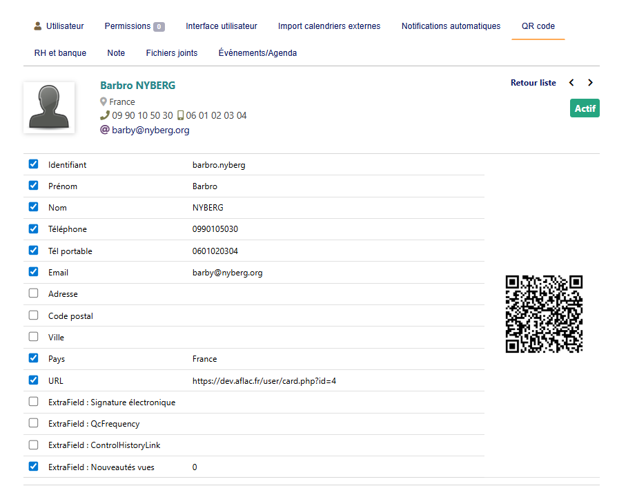

User
The user QR code encodes the business contact details (login, first name, last name, phones, email, address…), and the vCard QR code adds them to an address book. Handy for badges or internal business cards.
- Note: the QR code tab of a user is only visible to the user themselves or to users allowed to read user records.

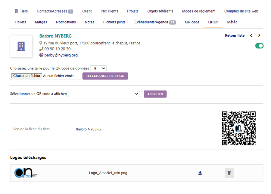

Reusable QR code image (QR with logo)
To get a QR code image with a logo to reuse elsewhere (website, brochure, e-mail signature), use the QR with logo setup tab:
- enter the record URL or any other content in the input field;
- choose the size and the logo, then click GENERATE;
- display the QR code again at any time with Select a QR code to display, print it or delete it.
- Note: the former "QR-Url" tab of third parties, which the module no longer declared, has been removed. The record URL QR code remains available in area 4 of every QR code tab.

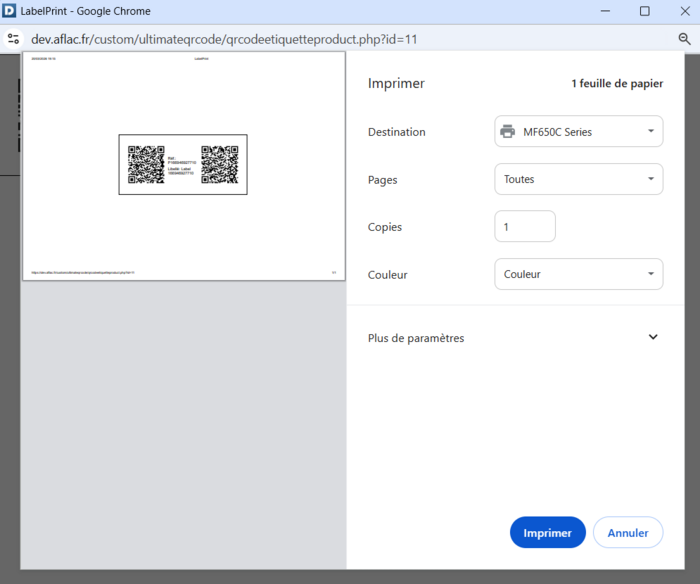

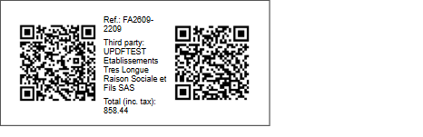

Label printing
The PRINT LABEL button, or a click on a QR code, opens a print window in 120 × 57 mm format, suited to common label printers.
The label of a record contains:
- on the left: the data QR code;
- in the centre: the key information of the record (reference, third party, total…, depending on the object);
- on the right: the record URL QR code.
The generators of the QR codes and QR with logo tabs print the QR code they have just created in the same way.
The window opens the browser print dialog automatically.
- Note: for best results on adhesive labels, set the printer to the 120 × 57 mm format and remove the margins in the browser print options.

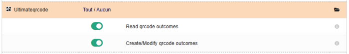

Permissions
The module defines two permissions, granted per user or per group in Users & Groups:
| Permission | Effect |
| Read QR codes | Shows the QR code tabs and the generated QR codes |
| Create / Modify QR codes | Lets the user tick or untick fields and save the configuration |
- Note: without the read permission, the QR code tabs are hidden. Without the modify permission, the user sees the QR codes but cannot change the field selection. Uploading, renaming and deleting logos is reserved to administrators.

| Logo management | Upload, preview, rename and delete logos from each record |

- The label does not print at the right size
- Check that the printer paper format is set to 120 × 57 mm and remove the margins in the browser print options.

- The QR code with logo cannot be read
- The logo covers too much surface. Use a smaller, ideally square, logo. The quality is already forced to High (H) as soon as a logo is selected.
- The QR code is displayed without logo although I selected one
- The logo is too large for the encoded content: the module then generates the QR code without the logo. Try a smaller logo or tick fewer fields.

- Where has the QR-Url tab of third parties gone?
- It has been removed. The record URL QR code is in the QR code tab (area 4), and the QR with logo setup tab creates reusable images.
