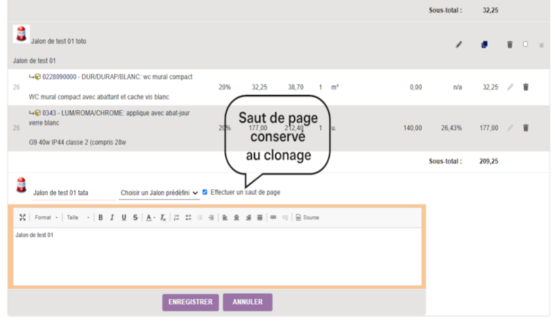

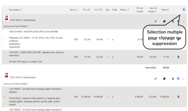

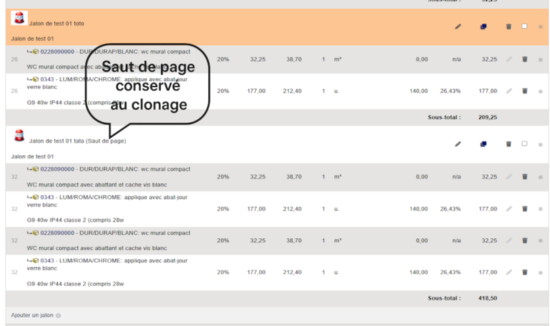

Main features:
- Line grouping: associate products/services with a milestone to group them visually and manage them as a block.
- Automatic subtotal: display the total amount per milestone on the document and in the PDF.
- Comment lines: add text lines without amount or VAT.
- Forced page break: insert a page break at any desired position in the PDF.
- Move a line into a milestone: attach an existing line to a milestone after the fact, using a dropdown menu.
- Block cloning: duplicate a milestone and all its child lines in a single click.
- Block deletion with options:
    • Option 1 — Delete the milestone and all its lines.
    • Option 2 — Delete the milestone only and detach its lines (they remain on the document).
    • Option 3 — Delete the milestone and migrate its lines to another existing milestone.

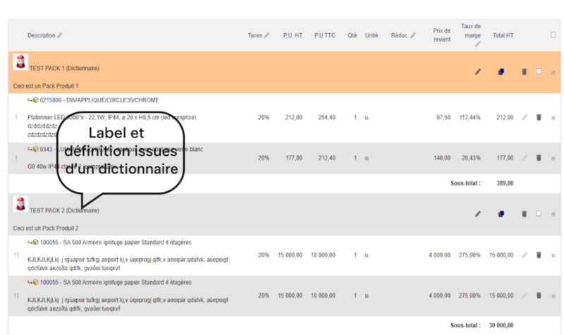

- Milestone dictionary: save reusable milestones from the configuration page.

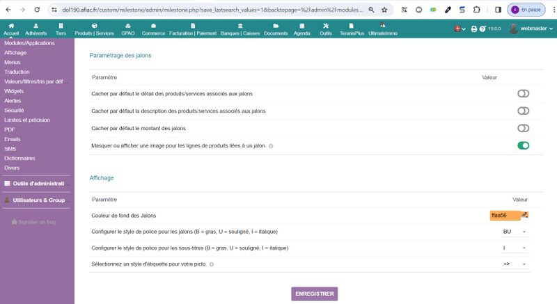

Module configuration
Module-specific configuration page:
The configuration page contains one tab:
  • Options tab
The following options are available:
- Hide by default the detail of products/services associated with milestones.
- Hide by default the description of products/services associated with milestones.
- Hide by default the amount of milestones.
- Set the background color of milestones.

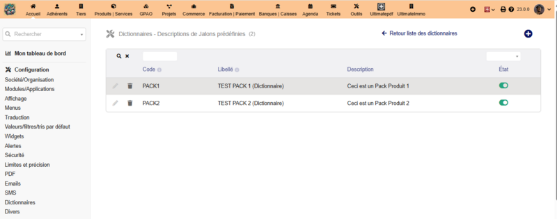

You can save milestones you wish to reuse in a dictionary.
