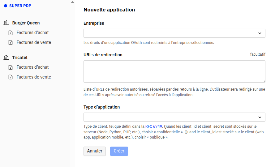

If you choose SuperPDP as your official Production Access Point (or as a Test Access Point), you must create an account by clicking on the link suggested by the setup page of the module (link should be https://www.superpdp.tech/app/users/create).
Note that for a production usage, you may need to provide a scan of an identity card. The process of creating an account may last few minutes.
Once your account is created, you must generate credentials to allow Dolibarr to connect to SuperPDP: For this, go into your SuperPDP dashboard, and from the left menu "Applications", click on "New Application" to create a new setup for the application Dolibarr. Choose if you want a setup for Production (Real usage) or for Test (Sandbox). Then select the company and the type of application "Confidential" and click "Create" (you can keep the field "URLs of redirection" to empty or paste the value provided by Dolibarr setup page).
The page to get credentials for an application
Your credential (client_id and client_secret) are created and are shown on the next screen.

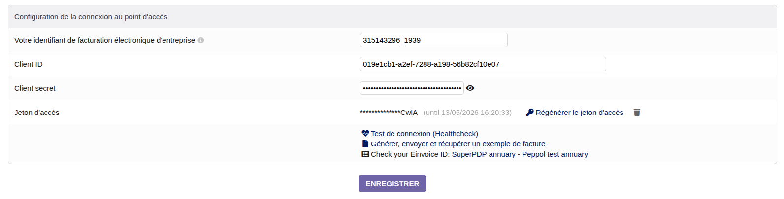

Go into Dolibarr, into the page to setup the module EInvoice and enter these 2 values, click on Save to save the data and click on "Connect" to get the security key to exchange with SuperPDP.
That's all, you are connected with SuperPDP (For Production usage or for Test depending on the choice you made). To be sure, you can try the link "Test of connection (healthcheck)" to verify the connection.
Example of setup for sandbox use with an account of SuperPDP
Warning.png By default, you can enter only one set of credentials for the Production mode and one set of credentials for the Test mode, so if your Dolibarr instance is a test instance, enter test credentials and set the switch to Test, and if your Dolibarr instance is a production instance, enter credentials of production and set the switch to Production. Even if you can switch from one environment to another one, it is seriously not recommended to save and use both Test and Production credentials in the same Dolibarr instance; Only the Access Point environment is different but your Dolibarr is the same. So if you mix two Access Point environments (Test and Prod) in the same Dolibarr, you may get or send tests invoices on your production instance (and the opposite), so the best thing to avoid this is to enter credentials only for one environment and never for the other. See chapter "Usage in sandbox for test" for more information on how to use the module in a sandbox context.

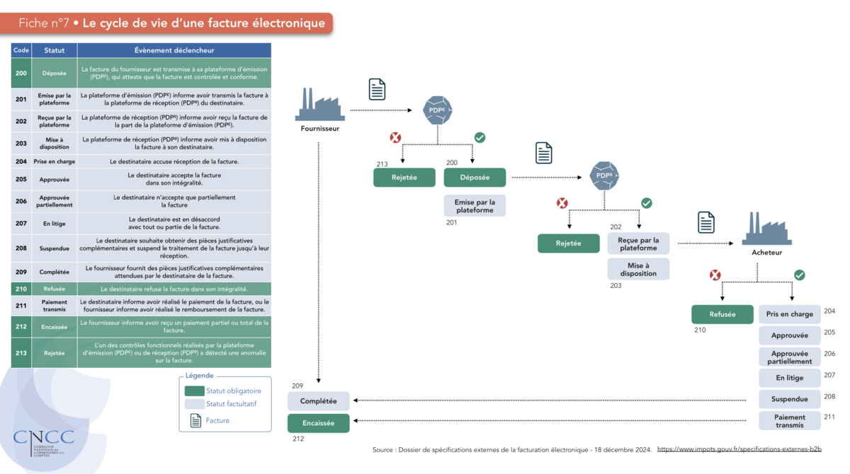

Once an EInvoice has been generated, you can use the button to "Send the invoice" to the access point. Wait a minute while the access point answers and observe the returned status code:
  • Code 200: the access point has successfully sent the invoice to the client and is waiting for an answer from the customer's approval
  • Code 213: rejected: the access point has detected an anomaly on the invoice. Review all invoice data and VAT fields. Download the FA-xxxxx_cii.xml file from Dolibarr and send it to a CII validator to get more information about the anomaly. If you need help, ask on the forum.
  • Code 210: the customer explicitly refused the invoice, get it touch with the customer to know why they did not accept the invoice.

Life cycle and error codes for French EInvoicing
Lifecycle of an electronic invoice
Current error cases
