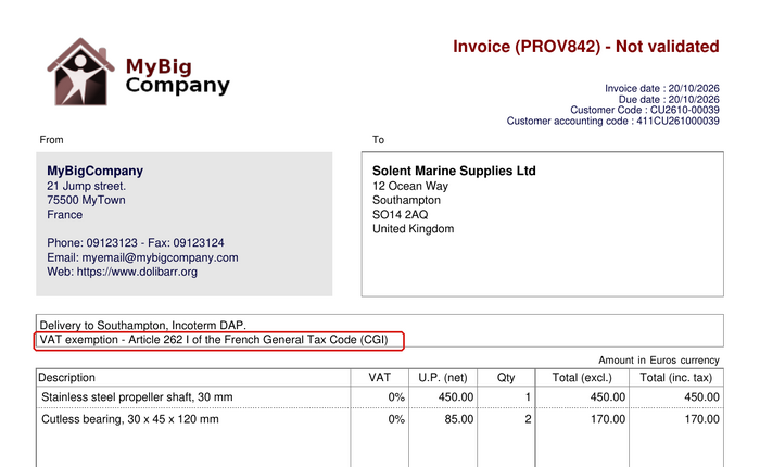

Doli Legal Mention prints on each customer invoice the legal mention its customer requires, such as the VAT exemption of an intra-Community supply or of an export.
The mention printed under the public note of the invoice, in the language of the customer

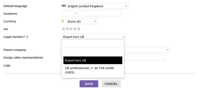

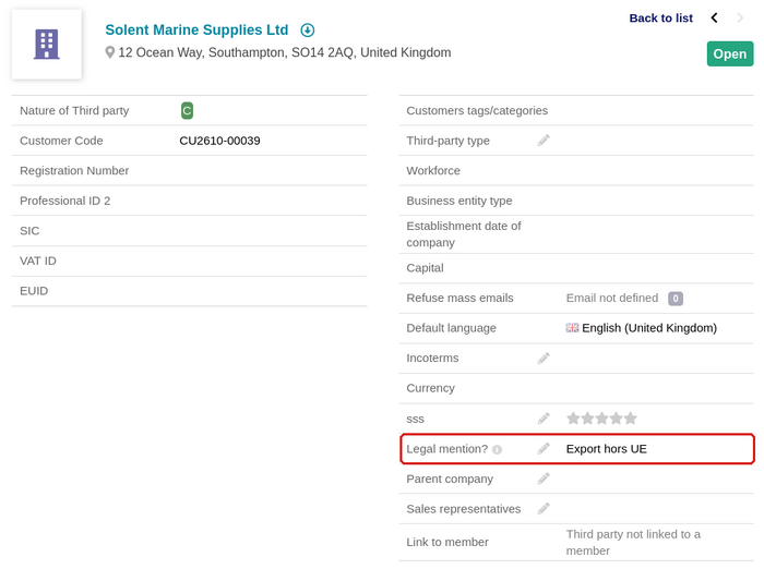

One mention per customer, chosen once
On the card of the third party, the field Legal mention? offers the list of the active mentions. You choose the mention once; every customer invoice of that third party then carries it. Leave the field empty for a customer who needs no mention.
The legal mention chosen on the third party card
The list of mentions on the third party card
Printed under the public note, with every PDF template
When the PDF of a customer invoice is generated, the mention is printed under the public note, as its last lines. Credit notes and down payment invoices follow the same rules. The module changes no PDF template: it works with every template that prints the public note, as the standard templates of Dolibarr do. It was tested with the Sponge and Crabe templates.
The mention is added for the time of the PDF only: the public note saved on the invoice never changes. A PDF already generated keeps what it printed; generate it again to take a new mention or a new text into account.

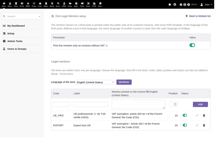

A list you manage yourself
The setup page of the module, reserved to administrators, holds the list: add, modify, translate, disable and delete the mentions. Choose a language and click Refresh to show and edit the texts written in that language. Disabling a mention stops printing it, and the third parties keep their choice: enabled again, the mention is printed again on their next invoices.
Code, label, position and status can also be edited in Setup - Dictionaries, dictionary Legal mentions. The texts are edited in the setup page of the module only.
The setup: the option and the list of mentions, with one text per language

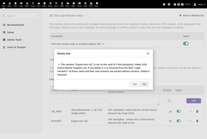

Deleting a mention still in use
When third parties carry the mention you delete, the confirmation window names them and says what they lose. Once you confirm, the mention is removed from their cards and their next invoices are printed without mention. To stop printing a mention without touching the cards, disable it instead.
A deletion made from the dictionary screen does not warn: the third parties keep a choice that no longer exists. Prefer the setup page of the module to delete a mention.
Deleting a mention still in use names the customers concerned
